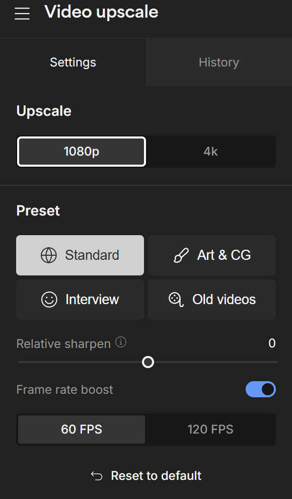

How to use frame interpolation in the Topaz Video Upscale tool
There's a newer, simpler way to take advantage of Topaz Labs' AI frame interpolation technology. By using our web-based Video Upscale tool, you can choose to apply a frame rate boost that will interpolate videos to make them either 60 fps or even 120 fps. Give it a try by heading over to our web-based video upscale and frame interpolation tool.
In addition to frame interpolation, you'll be able to accurately upscale videos up to 4K quality at the same time.
