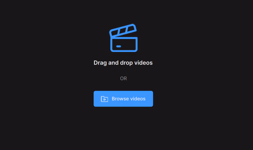

Import Your File
There are five ways to bring files into Topaz Video:
  • Open the app and select "Browse Videos" to navigate to your file.
  • Click anywhere on the screen to open a file browser window.
  • Drag-and-drop files directly into the app.
  • Use the “File” drop down menu and select “Import”
  • Use a keyboard shortcut of Ctrl+i (Windows) or Cmd+i (macOS).

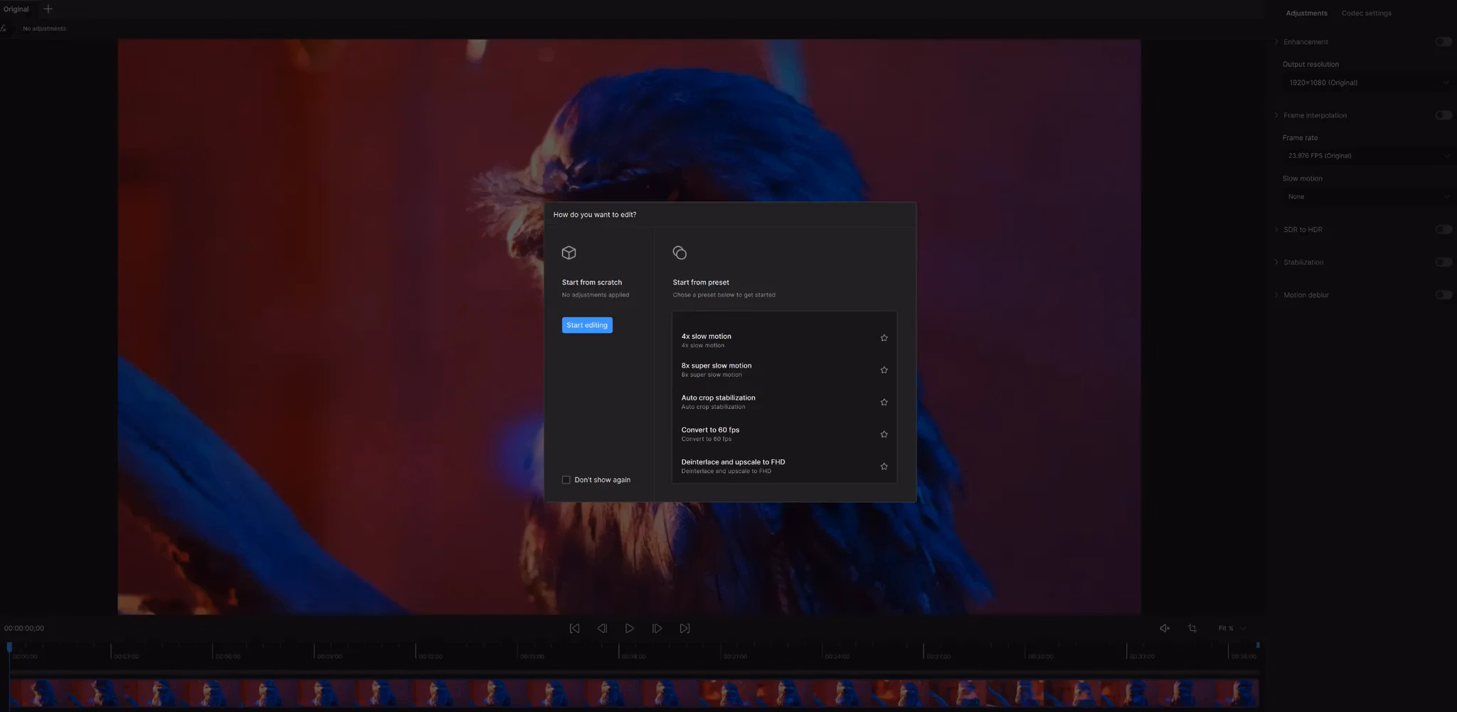

Start from Scratch or Preset
After importing your footage, you will see a pop-up menu where you can decide to either Start from scratch (without any established enhancements or filters) or Start from preset (begin from a set of established enhancements and/or filters).
Use the middle mouse button to scroll through all options. Note that you could always generate your own presets and favorite your "go to" presets.

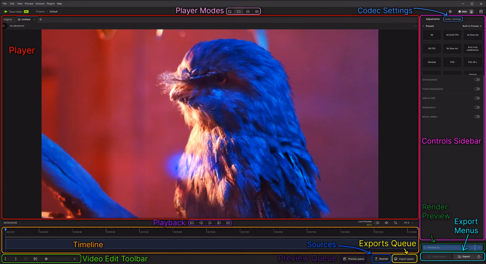

Workspace Layout
Once you've successfully Imported your file, you will see the main Workspace. As seen in the above graphic, the Topaz Video workspace is comprised of different sections.
Let's briefly go over each section and what they do:
Adjustments & Codec Settings
At the top of the Controls Sidebar you will find Adjustments and Codec Settings.
  • Adjustments: is a selection of tools that allow you to refine, enhance and manipulate your videos.
  • Codec Settings: provides a selection of output parameters and file types you intend to process your videos as.

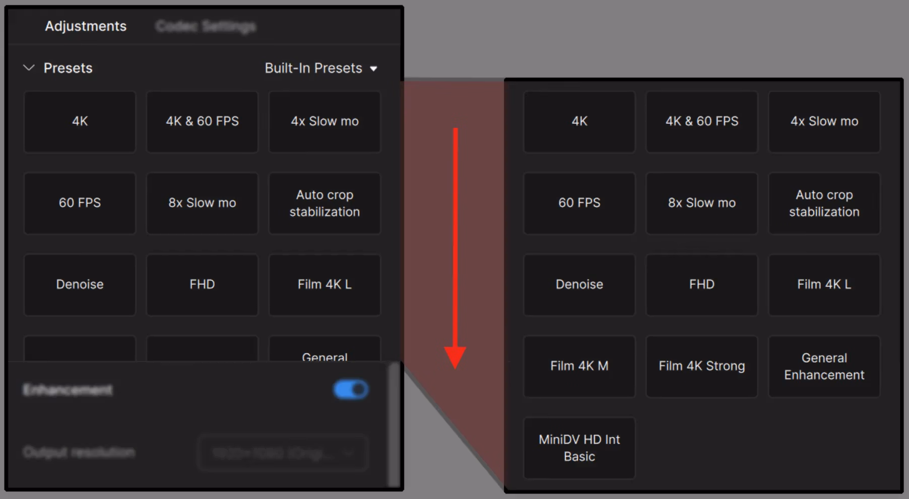

Presets
Presets is the first menu selection under Adjustments. This allows you to select built-in presets or custom ones you have built.
  • Use the middle mouse button to reveal the rest of the built-in presets or if you have several custom ones.
  • You can change which set of Presets you wish to view (built-in or custom) by clicking the small arrow button on the upper right side of the screen. Click outside of this menu to exit.
If you feel that the Presets menu is taking too much space, you can collapse the menu by pressing the caret next to the “Presets” word. You can always open this menu again by pressing the same caret button. Learn more about our pre-built presets in Topaz Video here.

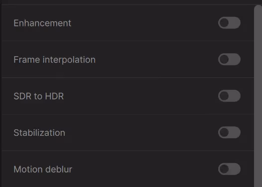

Filters
Each of Topaz Video's filters have been trained for a specific task such as de-interlacing, adjusting the frame rate, creating a slow-motion output and more.
Use the toggle switch to enable the filter(s) you wish to use. We recommend a maximum of two filters per file for faster performance.
Learn more about Topaz Video filters.

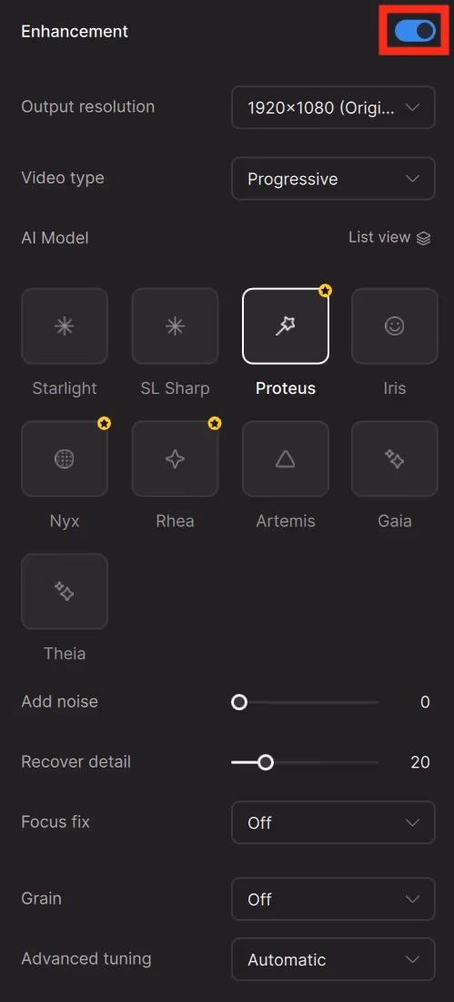

Enhancement
By default the Enhancement toggle will be enabled. This is indicated by the top right corner icon on this menu (outlined in red below). Additionally if the toggle was disabled the menu would be collapsed.

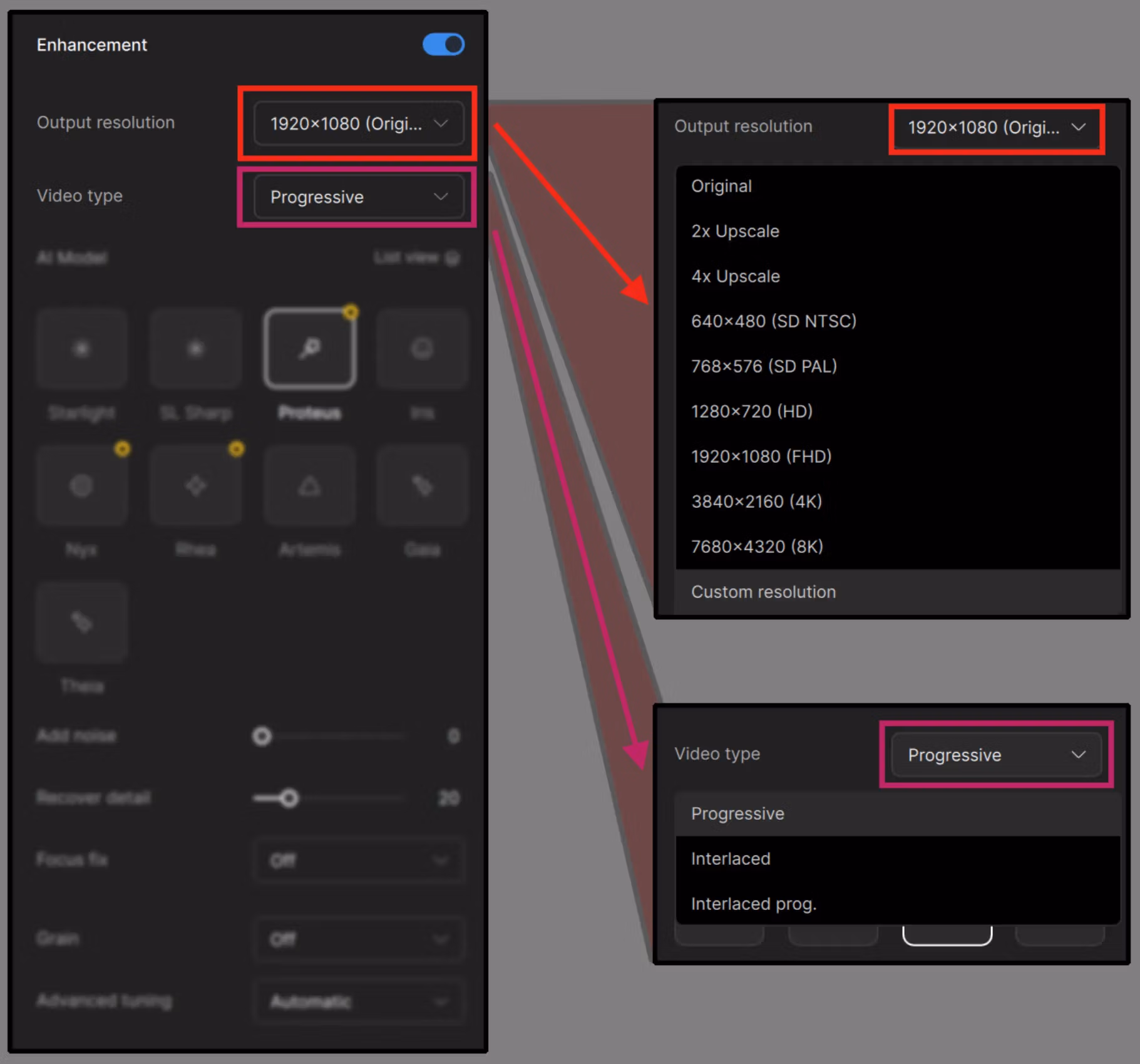

Video Setup
There are two major variables that we need to initiate for your “Video Setup" and that’s deciding on your Output Resolution and Video Type.
  • Output Resolution: This drop-down menu allows one to decide the final output frame size in scale.
  • Video Type: Here you will need to decide on the type of video you intend to use with Topaz Video. Each of these categories have a different group of AI Models. (Most consumer cameras from the early to mid 2000’s have been progressive).
If you are using a video file with non-square pixels, an additional menu option will appear to allow you to keep the original pixel type or convert to square pixels.
Learn more about Video Types here.

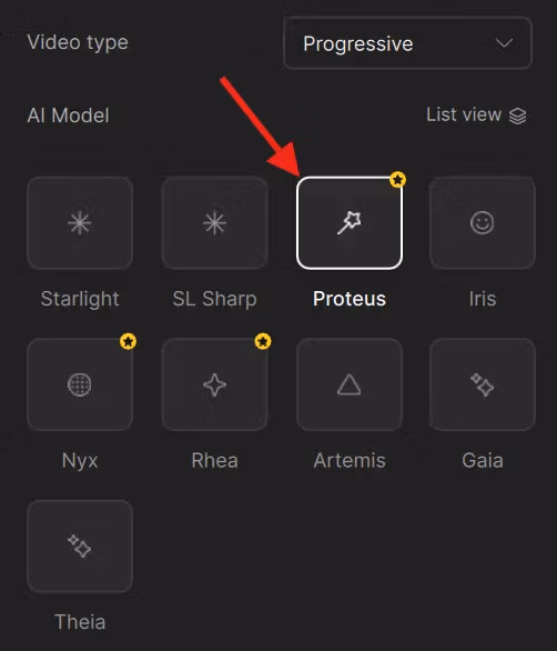

AI Models
When deciding on an AI Model to use, it is worth noting that a selected AI model is indicated by a white outline along the perimeter. If you prefer a list view rather than the icons for the AI Model, you can click on the “List View” text to make the change. You can now select the AI Model from a drop down menu and see the list.
Please note, if you wish to return to using the icons, you will need to make this change within Preferences. For your first video, I recommend starting with Proteus as this will give you a great idea on how the models work. Since this is one of the most commonly used AI models, it’s a great place to start before using some of the other specialized AI models.

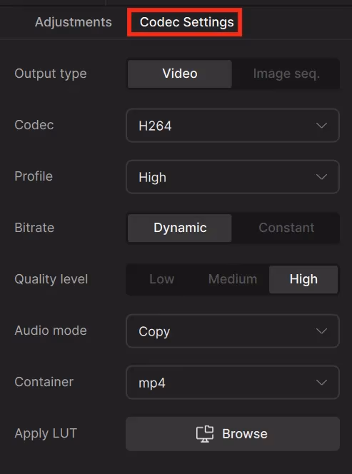

Codec Settings & Export Menus
  • Codec Settings: will allow you to select the export Encoder, Container, and audio settings.
  • Export Menus: allows you to process your videos out to its final output.
Codec Settings
Click on the Codec Settings tab from the upper screen right side of the Controls Sidebar.
Here you can make any changes you would like to the output video or image sequence file type. Additionally there are some audio parameters and a few other adjustments pending on the Codec file type you’ve selected. Please note that H264 is set as the default. This should be good for most cases up to 4K outputs.
Learn more about Topaz Video's Encoders and Containers.

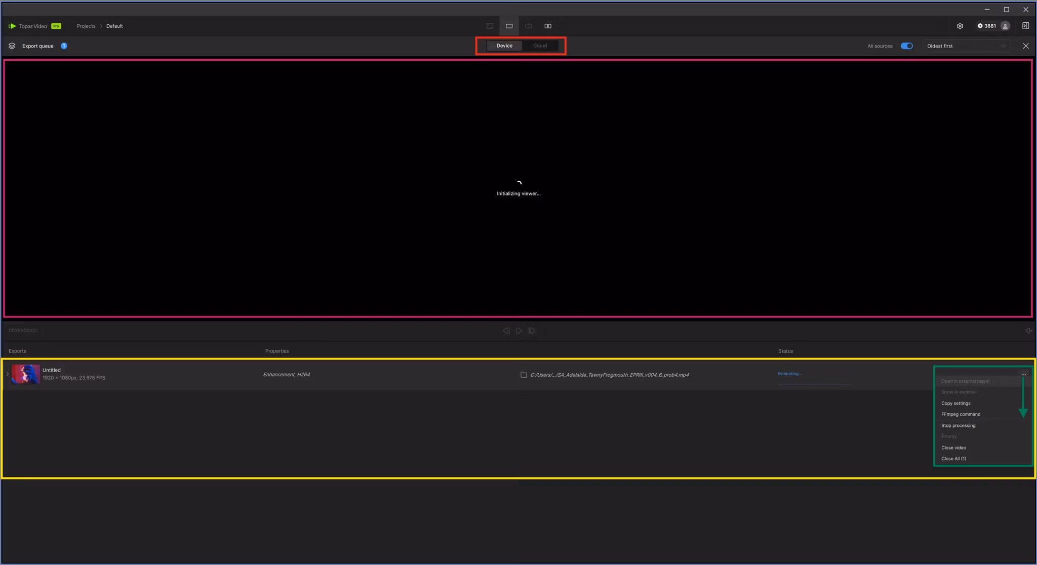

Export Queue
Once you have selected the method you wish to export, all of your exports are conveniently housed together in the Exports Queue. Click on the Exports Que to open this view.
In the Exports Queue view, there are a few main areas to note:
  • Export type (red): Device (local) or Cloud
  • Player (pink): Allows you to preview the render.
  • Export Task (yellow): This is the individual export task. If there were multiple, they will be aligned in layers below this one.
  • Additional Options “…” (green): This provides more things that can be done with the processing/processed task.
